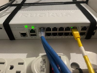

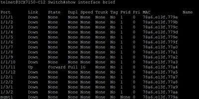

The only lights I can see are the SYST, PWR, and wifi LEDs and they are all solid green. (yellow cable is connected to my AT&T modem and the blue cables are connected to the APs; I am not sure which cables are connected to either AP and no lights are shown for either blue cable)

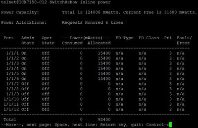

Below are the results from the suggested commands in the CLI (PuTTY) accessed by the Telnet:
enable:

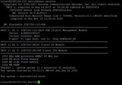

show version:
show flash:
show inline power:

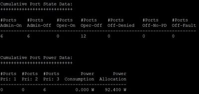

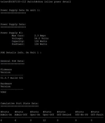

show inline power detail (2 photos):
show interface brief:

Hi @lc578
This issue is mainly because of the older version on your RUCKUS Switch.

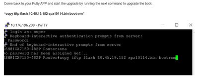

Hi Imran,
As I was going through the steps in the link, I came across a problem when trying to copy the mnz10114.bin file. Below is the instructions that I cannot get past as well as the error that follows. I have already searched for answers online but cannot find any. The error is "TFTP to Flash Error - code 5"
