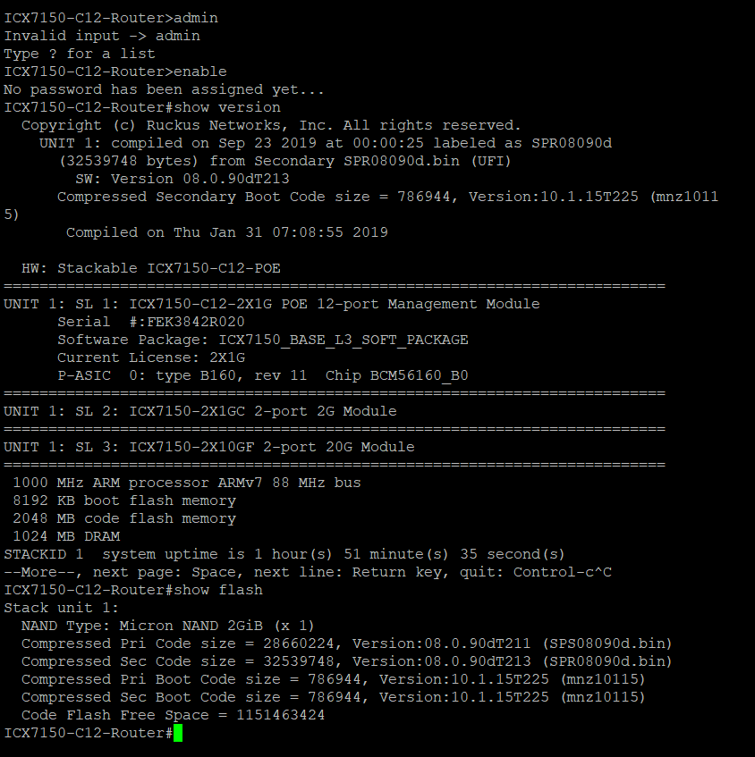

Thank you. The first combination worked. Do you have the firmware upgrade manual and what is the latest firmware for ICX-7150-C12P ?
Hi @jimmyvu324
Please let me know your current Switch version, to assist you on this further.
Please share the output of the below commands to confirm the same.
show version
show flash
Please see above
