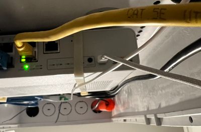

I decided to post a new one.  I am getting this same error, and I have seen many others have had this same issue.  Has Ruckus support finally resolved this?  I tried the reset with a pin and now, all I have is a green power light with all of the other lights blinking.  Please please please.  How do I get this resolved?
I have the ruckus 7150-C12P.

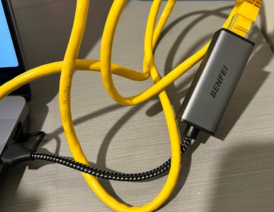

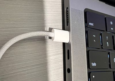

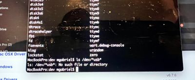

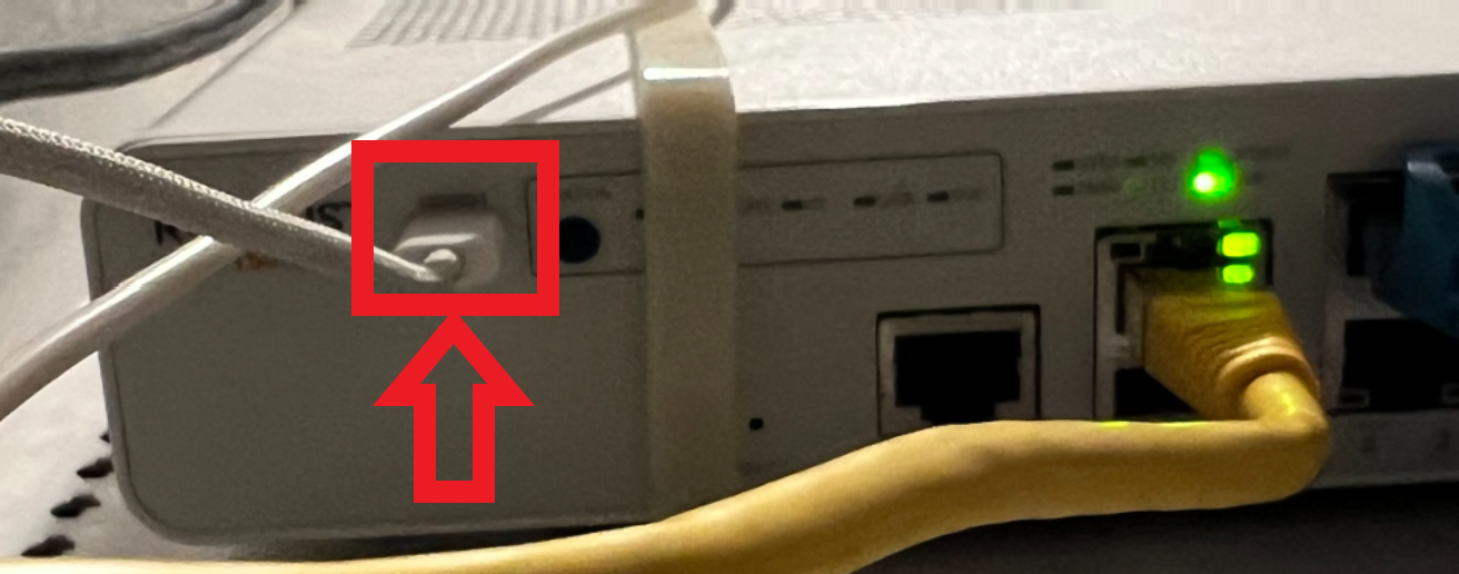

Could you please confirm if the Type-C cable is connected to your laptop? (Kindly refer to the screenshot below for reference.)
Additionally, please share a picture of the Type-C connection. If not connected, it must be connected, as that is the console cable for the CLI access.
Thank you once again for your patience.
Everything connected to my laptop is usb c.. yes
mrq201
Hi @mrq201
Thank you for sharing the requested information.
Based on the troubleshooting performed, your ICX-7150-C12P Switch is not responding to CLI/Console access, and the Software Recovery process has been unsuccessful. A hard reset was also attempted; however, the issue still persists.
As a result, this Switch unit appears to be defective and needs to be replaced through the RMA (Return Merchandise Authorization) process.
