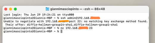

I used an app to locate the correct IP address
As you can see, it is now running on SPS0809K.
Should I reinstall using 0809H? (I installed the most recent version, but the moderator didn't respond to my question if that was an error)
After all of this, I'm still not able to connect to my access points for over a week. Please read this carefully and let me know if there is something I've done wrong or something I've misunderstood.
