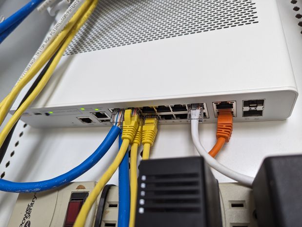

2. Please refer to the below picture and share a picture of the same, showing the light status and the FULL Switch panel cable connections to the Switch ports.

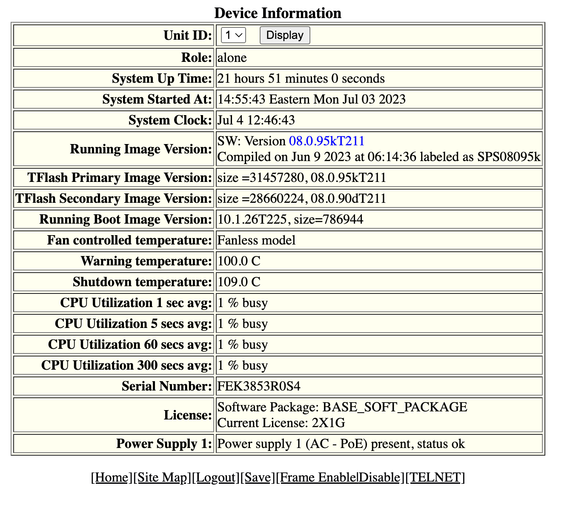

3. Please log in to the RUCKUS ICX-7150-C12P Switch and help me with the below screenshot.

2. See below for requested photo
3.

As per the light status of the RUCKUS ICX-7150-C12P, it is in normal condition. And your Switch is on SPS code as it required to be.
I see from the picture you shared, seems like the ethernet cable which is coming from the ISP (Internet Service Provider) Router or Modem/Router combo is plugged into the wrong port on the Switch panel. It must be plugged into any 1 in-12 ports as shown in the below screenshot. Please unplug the ethernet cable and plug it into the correct port and try again to connect from Access Point. If required reboot your ISP Router once.
Please refer to the short guide link below about how to connect the devices as reference:
Please check, confirm, and let me know if you have any queries in this regard.
