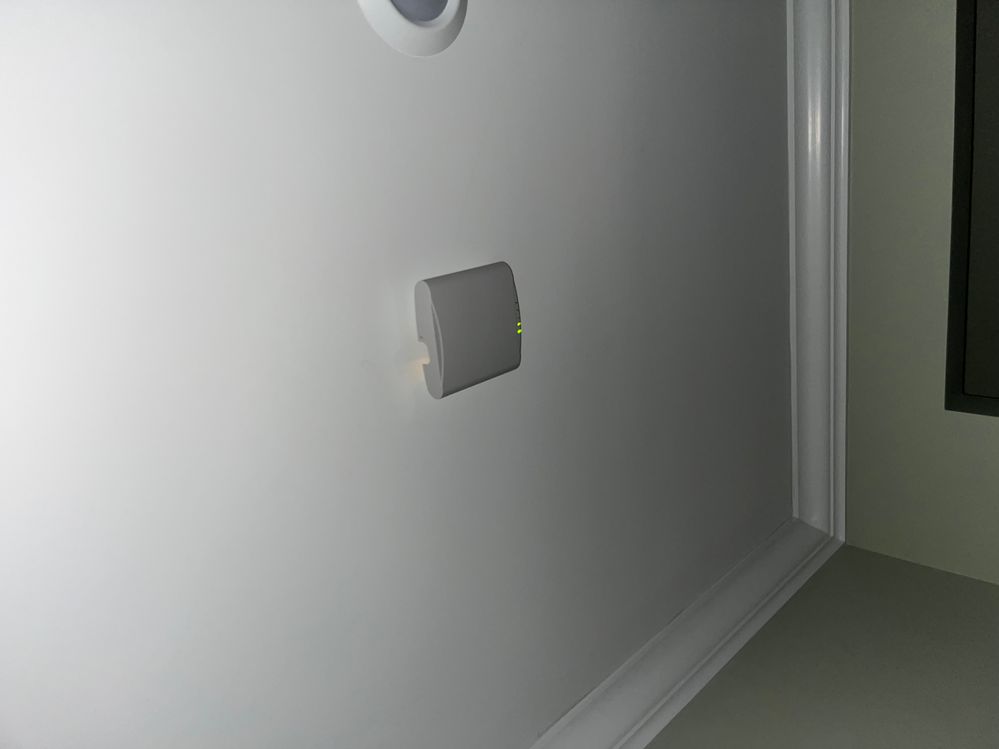

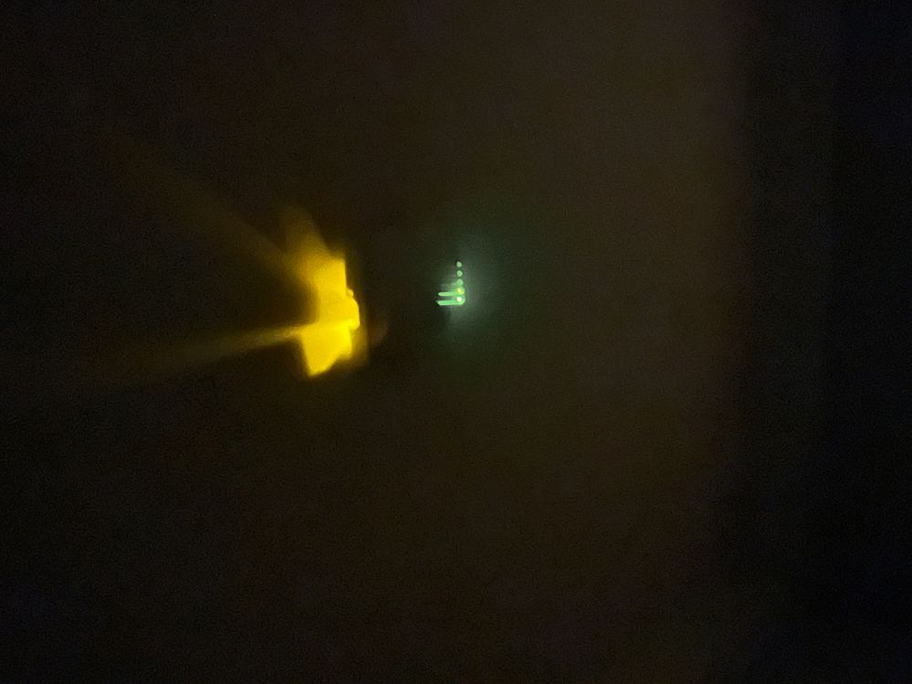

I have acess points in my home. One upstairs and this is the downstairs unit. The lights on the upstairs are green on the front and back. This is green and orange. Is this unit working correctly?

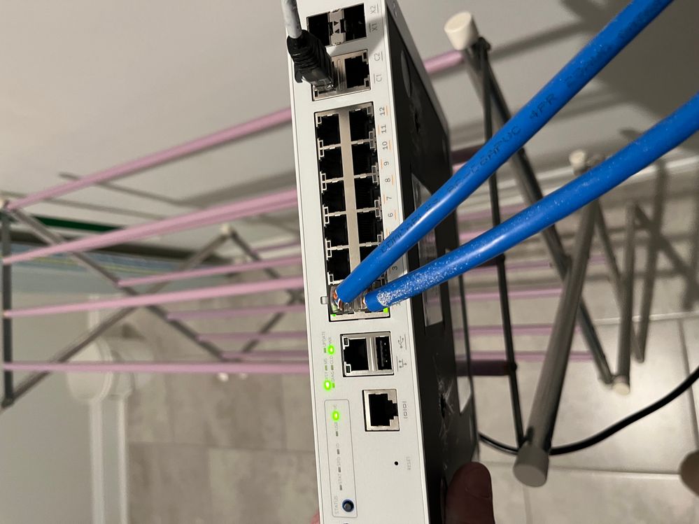

Hi @Mike1347
As per the light status of the RUCKUS ICX-7150-C12P Switch it seem to be in a normal status.
As I see from the picture you shared, seems like the ethernet cable which is coming from the ISP’s (Internet Service Provider’s) Router or Modem/Router combo is plugged into the wrong port on the Switch panel. It must be plugged into any 1 in-12 ports as shown in the below screenshot. Please unplug the ethernet cable and plug it into the correct port and try to connect to the Internet via Access Points. If required please reboot (unplug and plug from the power outlet) your Switch and ISP Router once.
If above process doesn’t work, we may need to check some Switch configuration. Please follow the below process for the same and help me with the queries.
Please follow the below steps and help us with the queries:
ICX7150-C12 Router> OR
ICX7150-C12 Switch>
show version
show flash

Hi @Mike1347
As per the case description, I understand that your RUCKUS setup is not working, and Access Points do not have power.
1. Was this working before or is it a new installation? If it worked before, was there any power outage before you started facing this issue?
2. On your switch while it's plugged into the outlet, do you see any lights on? (Amber or green) Please let us know which lights are on. (Please refer to the below picture and share a picture of the same, showing the light status and the FULL Switch panel cable connections to the Switch ports)
3. Is your Internet Connection from the Internet Service Provider (ISP) stable and working? (You could check this by connecting to your local router Wi-Fi or from an ethernet cable from the Router to a laptop/PC).
Please let me know the answers to ALL the above queries or let me know if you have any queries in this regard.

There was a power outage for about one minute. It was working prior to the power interruption. The internet has always worked and always comes back on after any power outage. Port C1 doesn’t have a light on, see enclosed photo

Hi @Mike1347
ICX7150-C12 Switch>
show version
show flash
