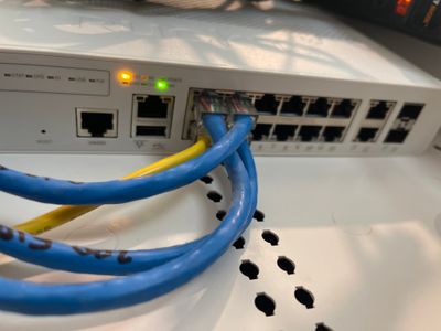

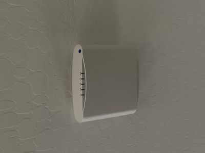

I had a power outage last night, but when the power turned back on my Ruckus R510 Access Points did not turn back on. I do have internet access through my internet providers router (Cox). I have unplugged my ruckus CX 7150-C12P several times and plugged back in. The CX 7150-C12P does have a green light indicating that there is power. The access points to not have any lights turned on. I’ve tried accessing my network through the unleashed app, but I get an error and am unable to. Please help me restore power to my access points. Thank you!

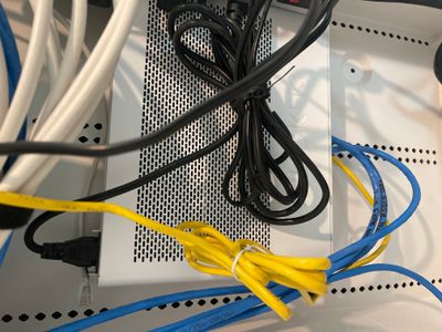

As you mentioned you have Green light on the Switch, kindly let me know about the SYST light . Additionally, please provide a photo showing the status of the lights and the full switch panel with cable connections to the switch ports.
Please upload these photos to your RUCKUS account before proceeding.

yes no problem. I did some digging on other posts and I think part of the issue is that it is stuck in boot mode. I did follow all of the steps listed in other posts, by unplugging and also resetting, but none of that has worked. The lights still show with green for power and amber for the other setting and there are no lights on either of my access points (2)
