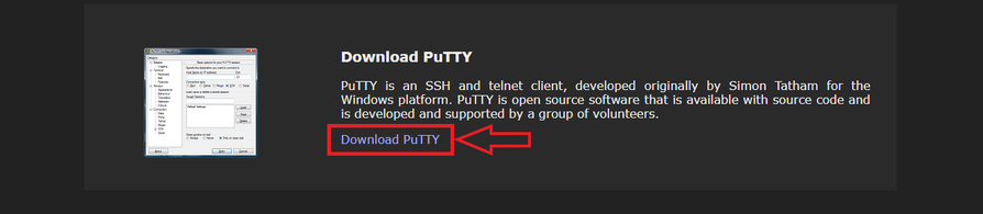

To access the Command Line Interface (CLI), you will need the IP address of the RUCKUS ICX-7150-C12P Switch and the PuTTY application. We can download PuTTY (Figure 1) and learn how to find the IP address of RUCKUS devices (Switch and Access Points) using free IP scanner tools.

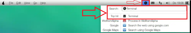

To access the CLI via SSH (Figure 2), you will need valid login credentials (username and password). If the credentials are unknown, you may attempt to use the default login details.

Example "open terminal":
SSH:
ssh username@IP Address of the device
