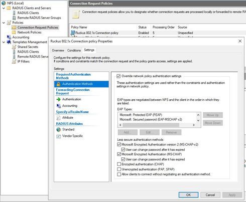

Then create a connection request policy. Overview tab is a name and the rest default then the conditions tab is as follows.
The settings tab is default except for the authentication methods.
If you edit the EAP type then you can select the certificate to use.

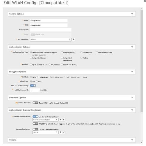

On the VSC or SZ controller it looks like this. Create a Radius Server Connection under Services/Profiles/authentication.
Create a WLAN that uses 802.1x. The picture in this one is named cloupath but disregard as it is one I use for testing lots of different things.
