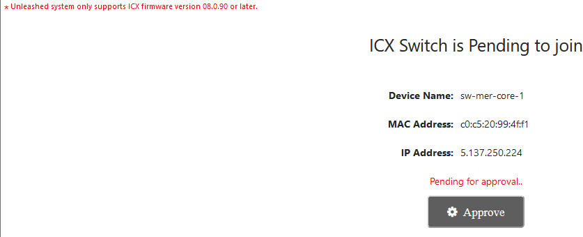

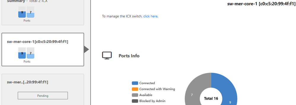

I recently upgraded my ICX7150-C12P to 10.0.10f SPR firmware from the 09.0.10j.cd4 SPS and since re-adding the switch to unleashed i have the problem that the switch keeps wanting to join on 5.137.250.224.(see screenshot below) Even tho the switch is already connected to unleashed and otherwise working fine.
When approving this "switch" it isn't able to communicate to this specific interface, it also can't be removed. Removing the existing switch doesn't resolve it either. I can get it working again by specifing the correct IP in unleashed for the discovery, but then i get the annoying 5.137.*.* IP back in the approval list. This isn't a valid IP in my subnet, and also never set in the switch. The switch has also been factory reset since the firmware upgrade and the troubleshooting.
Unleashed logs report: Failed to add ICX [c0:c5:20:99:4f:f1]. The ICX already exists. Please enter a different one. The MAC address from the one i specified (my managemt ip) and the one unleashed tries to connect (5.137.*.*) are the same (?)
I'm running unleashed version 200.16.7.0.402, i have tried to upgrade 200.17 but this gave me alot of issues with my R350 AP's.
Schermafbeelding 2024-12-28 172006.pngSchermafbeelding 2024-12-28 172020.png
I would like to keep on the 10.0 track now, but if there isn't any fix or update expected soon i think it's the best to go back to the 9.0 track.
