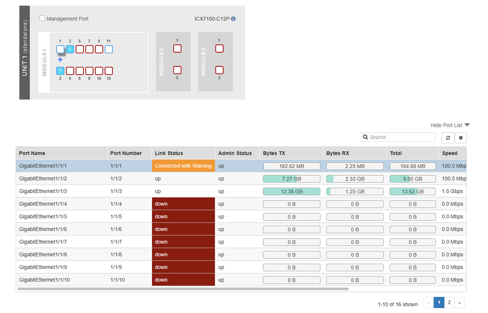

One of my AP's on my switch (port2) is currently only showing speed on 100 mbps instead of the 1.0 Gbps speed that it is suppose to be.  Is there a way to change the speed on switch port?  See attached screen shot from ruckus unleased admin login.  Also port 1 which does not have an ethernet cable connected to it show a warning status.  I tried resetting the port with no luck.

You likely have a bad cable. Try a different one and see if the 1gbps speed comes back.

It sounds like the issue with your AP on port 2 showing only 100 Mbps could be due to a few factors. To ensure the port runs at 1 Gbps, you should verify the following:
  1. Check Cable and Connection: I recommend trying a different Ethernet cable, to see if the 1 Gbps speed is restored.
  2. Verify Port Speed Settings: By default, ICX switches should automatically negotiate the speed with connected devices. However, you can manually force the port to 1 Gbps with the following command:
interface ethernet 1/1/2
 speed-duplex 1000 full
This command sets the port speed to 1 Gbps and ensures full duplex operation. Make sure to replace 1/1/2 with the correct interface if needed.
  1. Check for Errors: Run the command show interfaces ethernet 1/1/2 to check for any errors
For the warning status on port 1, it's likely showing "Link Down" because there's no cable plugged in. This is expected and should resolve once a device is connected.
