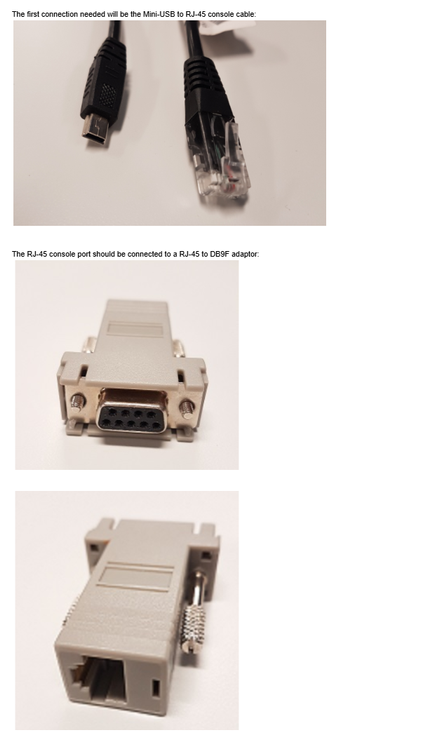

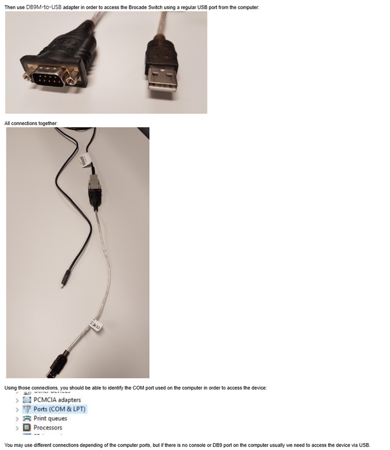

02-03-2026 07:55 AM
It's a bit messy if I am being honest (much easier on newer models). Here is what it normally looks like:
02-03-2026 07:57 AM
Just to be clear, the box is passing traffic just fine? If so, I would assume fastiron is loaded.
02-04-2026 09:36 AM
Sorry but I missed the button "Load more replies" and had not seen replies.
Yes I agree that is a little bit messy, new models with a USB-C or RJ45 serial console are way better.
The traffic is passing fine, I suppose too that fastiron is loaded.
