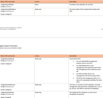

Hello, I'm trying to monitor my switch's CPU load, memory util, and temperature through a third party network monitoring tool (PRTG). I have been looking everywhere for the snmp OIDs to do so but can't find them anywhere. My switch's version is 08.0.95mT211.

Hey Inphobia, thank you very much for your answers. I ended up finding an oid that returns a table for the CPU utilization which works perfectly. The memory used sensor OID you provided in your screenshot is outdated I believe because the value returned is always <0.01Gb, the Dram total sensor works and the Dram Used OID you provided seems to actually be the DRAM free but it works. The problem is, I have a stack of three ICX 7250's at the IP that I'm monitoring but the sensor only monitors one of the switches.

You're absolutely right. I can't thank you enough for all of your help. I added the memory used as a percentage this time, it gave me the same result as when I calculate the percentage myself using the values returned from the dynamic memory total and used. I will be replacing the dynamic memory sensors with that one for sure. I opened a case with RUCKUS to see if there is a way to monitor all of the switches in a stack, if ever they get back to me with a way to do it I'll be sure to post it here.
