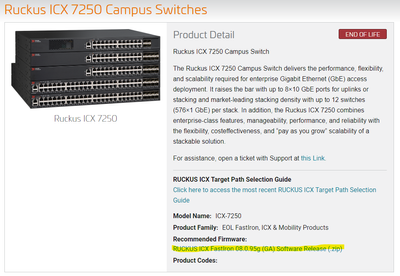

I certainly understand the frustration there. Moving back from 9.x to 8095 is also not a trivial item as syntax has changed between the two. Upgrading is seamless, but downgrading is not. You will want to make sure you either have your 8095 config handy (if you had one) or be sure to do the new config via console. As for the code, you can always check our product page to see our recommendation. Please see the attached screenshot:
https://support.ruckuswireless.com/products/105-ruckus-icx-7250-campus-switches#sort=relevancy&f:@co...]
I would always start here and then change code if required. A newer patch in the same codestream (ex. 8095h) is also generally a safe bet.
