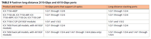

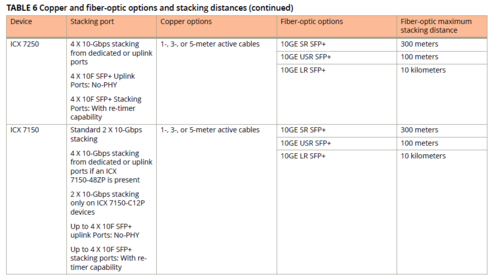

Please check the stacking guide for 8070 code I recommend going with 8070f Code, we have two types of images Routing and switching.  Not sure what version if it is routed or switched code you are running now and what model of 7150 you have:
https://support.ruckuswireless.com/documents/2125

In a ring topology, all stack members must have two stacking ports; however, in a linear topology, both end units use only one stacking port, leaving the other port available as a data port.
Image_ images_messages_5f91c458135b77e247a3857e_ffd30c06b911fd4f39ac517f56add440_RackMultipart201910072671i5fzy-e2aaf4a1-664e-4219-8569-d5f090efdd91-1930293813.PNG1570430725
Image_ images_messages_5f91c458135b77e247a3857e_7401527cdd4bbafc3f232182885ddce7_RackMultipart20191007818941jbe-27af6b47-2c26-480b-b865-8c87acdd376a-1448980477.PNG1570430841
