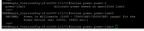

Ruckus ICX switches support standards based PoE.....they also support some some pre standard and propriety based PoE options. with that said...here is a URL to a location that describes why Ruckus might not support passive PoE. With that said you can set the limit on the power output of the switch port.......I would do that prior to any testing....the settings are based on milliwatts ...........https://ethernetalliance.org/blog/2018/02/06/the-hazards-of-passive-poe/

Image_ images_messages_5f91c456135b77e247a2fe90_ede3fe3685495d608c19832f2555b14c_RackMultipart2020071412849216m-b0bde17a-2723-4b27-a032-aa6bc2ac12aa-1953228092.PNG1594755352
