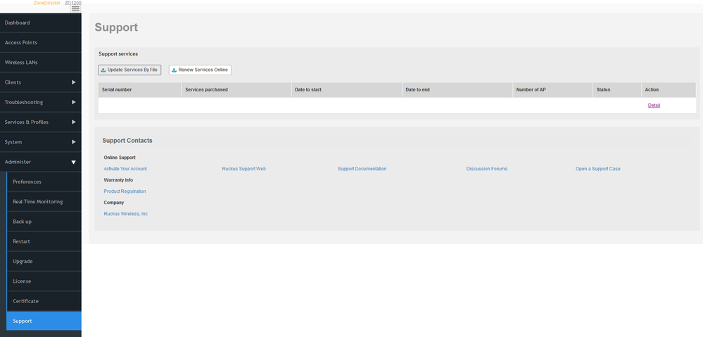

Hi @ETO
These are only needed when you are using an SNMP tool to monitor certain information (snmp traps and polling). Simple Network Management Protocol (SNMP) is a set of protocols for managing networks. SNMP sends messages to different parts of a network. SNMP-compliant devices, called agents, store data about themselves in Management Information Bases (MIBs) and return this data to the SNMP requesters. Are you using SNMP ? If not you can ignore the SNMP MIB as they are of no use to you.

08-06-2023 02:32 AM - edited 08-06-2023 02:34 AM
Thank you for answer.
Can you please let me know which monitoring tool did you mean?
I tried to check on ZD1200 interface on website but didn't find any thing.
See picture if is in any help?
Do I even need to upload this file or it will work fine also without it?
