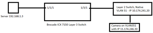

We have a closed network environment with NO ROUTER, but we do have a layer 3 switch. Please refer to the diagram; we have a server with IP address 192.168.1.3/24 with gateway of 192.168.1.1 The server is connected to Ethernet port 1/1/1 of the Brocade Ruckus ICX 7150 switch which has vlan 192 untagged with ve 192 on IP address of 192.168.1.1.
We have a fiber link on port 1/3/1 that goes out to a layer 2 switch. On port 1/3/1 we have vlan 51 tagged with ve 51 on IP address 10.174.241.99 and vlan 351 with tagged ve on IP address 11.174.246.99.
From the Brocade Ruckus we can ping the Layer 2 switch at 10.174.241.20, the Camera at 11.174.246.30, and the server at 192.168.1.3. From the server we cannot ping or communicate with the camera at 11.174.246.30.
On the server we even added static routes:
route add 10.174.241.0 mask 255.255.255.0 192.168.1.1
route add 11.174.246.0 mask 255.255.255.0 192.168.1.1
What are we missing?
