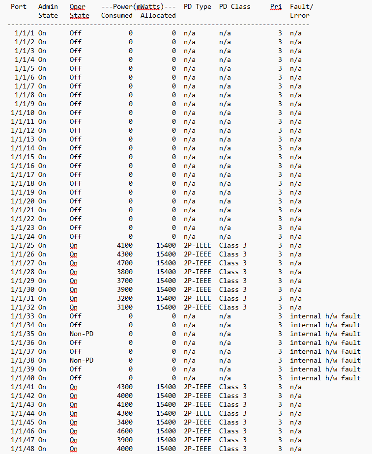

We are currently facing an issue with our ICX7150-48P switch, where several ports are showing a PoE fault status. Below are the details:
Issue Summary:
Some ports display “internal h/w fault” under PoE status, while others are functioning normally
Kindly advise whether this issue can be fixed through configuration or firmware update,
or if an RMA replacement is required.

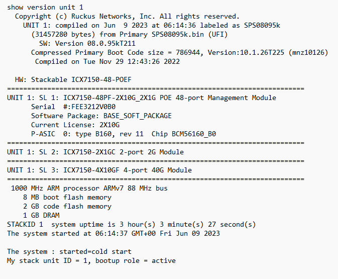

10-14-2025 05:08 AM
hi Chandini
good day
show version:-
UNIT 1: compiled on Jun 9 2023 at 06:14:36 labeled as SPS08095k
(31457280 bytes) from Primary SPS08095k.bin (UFI)
SW: Version 08.0.95kT211
Compressed Primary Boot Code size = 786944, Version:10.1.26T225 (mnz10126)
Compiled on Tue Nov 29 12:43:26 2022
HW: Stackable ICX7150-48-POEF
UNIT 1: SL 1: ICX7150-48PF-2X10G_2X1G POE 48-port Management Module
Serial #:FEE3212V0B0
Software Package: BASE_SOFT_PACKAGE
Current License: 2X10G
UNIT 1: SL 3: ICX7150-4X10GF 4-port 40G Module
8 MB boot flash memory
2 GB code flash memory
1 GB DRAM
STACKID 1 system uptime is 3 hour(s) 3 minute(s) 27 second(s)
The system started at 06:14:37 GMT+00 Fri Jun 09 2023
The system : started=cold start
My stack unit ID = 1, bootup role = active

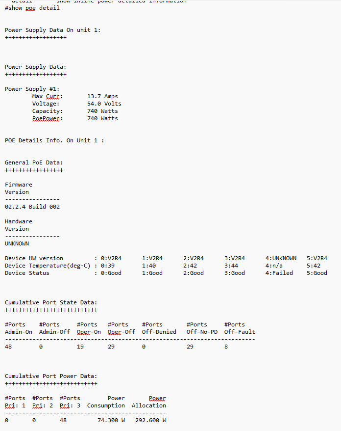

#show poe detail
Power Supply Data On unit 1:
Power Supply Data:
Power Supply #1:
Max Curr: 13.7 Amps
Voltage: 54.0 Volts
Capacity: 740 Watts
PoePower: 740 Watts
POE Details Info. On Unit 1 :
General PoE Data:
Firmware
Version
02.2.4 Build 002
Hardware
Version
UNKNOWN
Device HW version : 0:V2R4 1:V2R4 2:V2R4 3:V2R4 4:UNKNOWN 5:V2R4
Device Temperature(deg-C) : 0:39 1:40 2:42 3:44 4:n/a 5:42
Device Status : 0:Good 1:Good 2:Good 3:Good 4:Failed 5:Good
Cumulative Port State Data:
#Ports #Ports #Ports #Ports #Ports #Ports #Ports
Admin-On Admin-Off Oper-On Oper-Off Off-Denied Off-No-PD Off-Fault
48 0 19 29 0 29 8
Cumulative Port Power Data:
#Ports #Ports #Ports Power Power
Pri: 1 Pri: 2 Pri: 3 Consumption Allocation
0 0 48 74.300 W 292.600 W

Hi Elnoor
Acknowledged, and thank you for sharing the details. Please proceed to log a case with us and request an RMA for the device.
In the meantime, you may test the device using version 8095s and verify if "show poe detail" output remains the same.
Thank you
