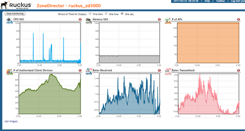

luciano_alabama
Hello,
Ok it's better now, I did a restart then an uppgrade to our ZD, and this is the graph for the last day.
There is still some spikes and I am wondering if it's really normal... is it ?
However I don't have any spike at 100% like before... and the memory is much lower. (the restart helped, for sure)
Well let me know please guys if you think about something wrong in our configuration, and thanks a lot for your previous reply.
Have a good day.
Image_ images_messages_5f91c434135b77e2479b6901_fa77f6ebd742311187ca64e981209330_RackMultipart2017042448385b8kd-1321d154-c548-4815-9d02-b3dcd6ec6453-807695607.png1493014901
gupta_pallapot1
New Contributor III
Good to hear that upgrade helped!!
These spikes should be fine, as its only  3~4 times in a day and they haven't even crossed 80% of the utilization.
