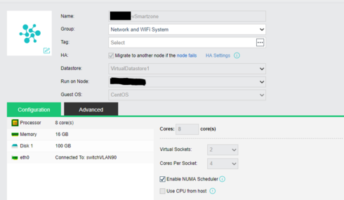

Current Specs of the VM (virtual smartzone)
Image_ images_messages_5f91c3fe135b77e24790f3d1_2d3887df1e779d6803d681eb1be1dd98_RackMultipart20190828960881tkz-2d0248ad-4d18-4763-9d02-5904a85ecd0c-364206121.png1566954298
can anyone help me how many users do 1GB of RAM can accommodate? sometimes the vSZ is experiencing "out of service" and the utilization is high. The vSZ is being used in a University most of the users accessing the APs are students.

There are multiple resource levels. I don't think you'll gain much by adding a gig or two except maybe for cache performance. The release notes have the different levels that will get you number of clients, etc but there is nos specific gain from having more ram

but how about lack of RAM / Memory for example: if we have 100 users and at least we need 1GB of RAM per 5 users then we need 20GB excluding the overhead of the Ruckus Virtual appliance and we only configured 16GB of RAM
There is one troubleshooting that Ruckus Support did and suggested that there is 20MB of memory remaining for the Virtual Appliance. This is one of the concern we have for the resources being used bu the Virtual appliance
We need to know the RAM allocation per user??

If you look at the release notes and install guide you'll notice they mentione resource levels. If your VM is not aligned with one for the resource levels it should not come up. The resource levels defines the numbers of clients and aps that can be handling. Check against those guides to see if you're exceeding those numbers.
Also, in your previous post you never mentioned what hypervisor you're running nor what back end storage or how many other VMs are sharing the host.
Iny lab I had run smartzone on a smaller server (while satisfying ram and cores requirements) but performance was awful since my CPU cores were very underpowered.

Hi Diego thanks for the response.
The hypervisor that is being used is SANGFOR Hyper Converged Infrastructure Solution and it runs on HDD, I'm not sure how many VMs are sharing the host. This issue occurs even before it was recently migrated to SANGFOR HCI.
