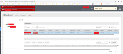

Our client has encountered this issue again
this issue occurred a month ago also prior to that and it happen again yesterday
what our client does is restart the VM to get it back on service
they already migrated this VM to a new server SANGFOR HCI
but the issue still persist
Please see attached image:Image_ images_messages_5f91c3fe135b77e24790e1b7_08a3bf770a5d81b18f120ec9b377dafc_RackMultipart20190820707321go8-a961633f-34d3-4c3d-86d4-7613a05f546e-248710525.png1566268530
any idea what's causing this issue?

without any details its hard to know. Are there any alarms regarding CPU utilization / Disk usage? Is the hypervisor overprovisioned? Also, this is not a zone director but rather smartzone. And if you have support issues, you should have a support contract and open a ticket. The forum is mostly run by other users who volunteer their time.
