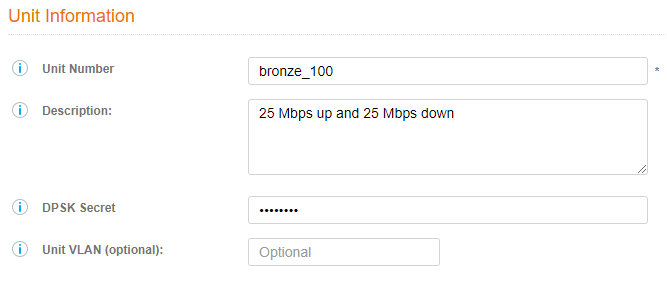

Cloudpath; create a bronze and a gold unit.
- Click on Managed Access | Property Management
- Click on the property that you want to change a unit to
- Click on Units Tab

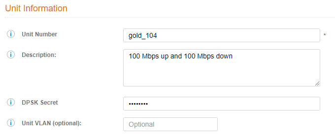

- Create a Unit; pre-pend the word “bronze” in the unit number:
- Do the same for a “gold” unit:
If you look at the bronze unit, you can see that the DPSK reference name is named as <property_name>_<unit number>. We can use this value to build a RADIUS DPSK policy on:

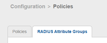

- Click on Configuration | Policies

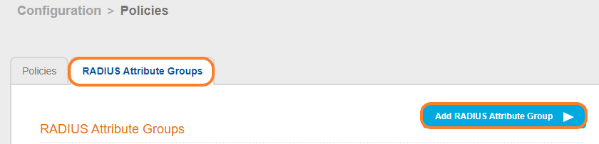

- Click the RADIUS Attribute Groups Tab

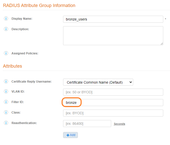

- Click on Add RADIUS Attribute Group

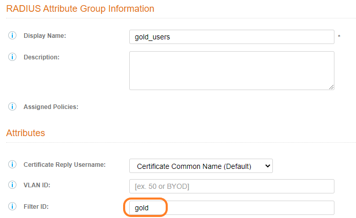

- Create a attribute group that returns the “Filter ID” as “bronze”
- Click on Save
- Let’s do another policy for “gold”, so click on “Add RADIUS Attribute Group” again
- Create a gold attribute group that returns the “Filter ID” as “gold”
- Click on Save

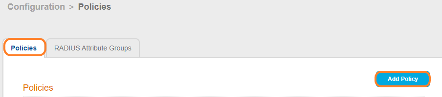

- Click the Policies Tab | Add Policy

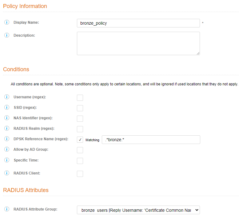

- Create a “bronze_policy” that returns the Bronze Attribute group that you just created. We are going to use the DPSK reference name for the Unit (remember, we pre-pended the word “bronze” to it):
- Make sure that you have a “.*” at the beginning and end, which means, match anything, then the word bronze, and match anything after that. This is REGEX, and I typically use a few different sites to test these things.
- Make sure that you select the correct RADIUS attribute group you just created for BRONZE
- Click on Save.

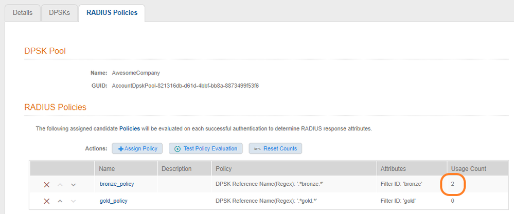

- You should have 2 policies now:

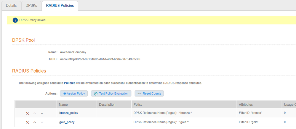

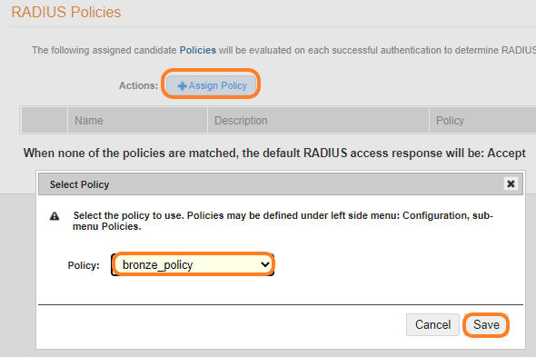

- Let’s apply the policies to your DPSK pools, click on Configuration | DPSK Pools
- Click the wrench beside you DPSK pool for the unit
- Click the RADIUS Policies tab
- Click on “+ Assign Policy” button
- Select the Bronze Policy and click on Save
- Do the same for the gold policy

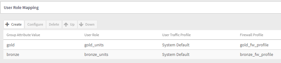

SmartZone:
Now that Cloudpath is setup with policies to return a different Filter ID to SmartZone, SmartZone has to be configured to take that value and apply it to a user role.
- In SmartZone, edit the Cloudpath Authentication Server
- Scroll to the bottom of the Cloudpath Authentication server window to “User Role Mapping”
- Click on the Create button
- The Group Attribute Value MUST match the Filter ID returned from Cloudpath (“bronze”):

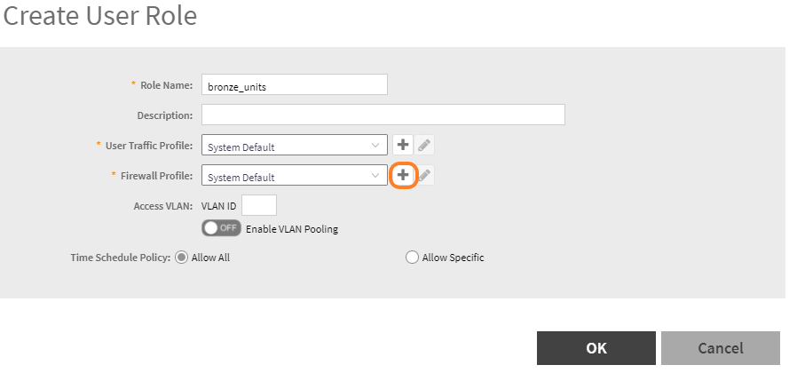

- Click on the + button to setup your parameters for the user.
- We are going to add a role name of “bronze_units” and add a firewall profile for 25 Mbps service
- Click on OK
- Click on OK
- Click on OK to return to the user Role Mapping screen

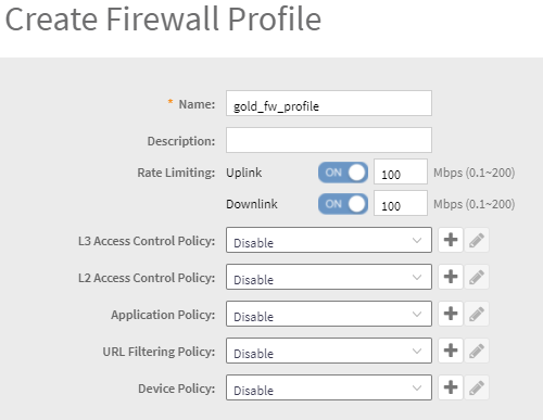

- Create another one for “gold” with 100 Mbps FW traffic profile
- Group attribute Value needs to match the “Filter ID” returned from Cloudpath, in our case “gold”
- Create a User Role and a FW profile like we did for bronze, but for 100 Mbps service
- Click on OK
- Click on OK
- Click on OK
- You should have two user-role mappings
- Click on OK to close the Cloudpath Authentication Server.
