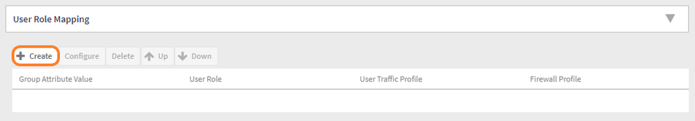

  1. In SmartZone, edit the Cloudpath Authentication Server
  2. Scroll to the bottom of the Cloudpath Authentication server window to “User Role Mapping”
  3. Click on the Create button

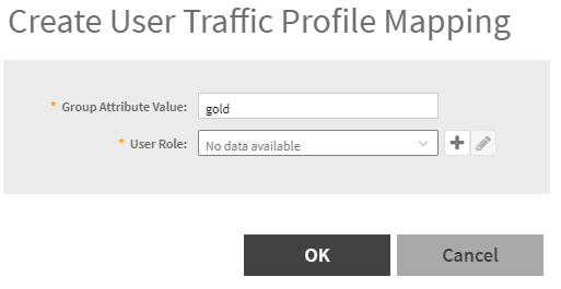

  1. The Group Attribute Value MUST match the Filter ID returned from Cloudpath (“bronze”):
Image_ images_messages_6092b45fa31fd9684f29c596_7e0519751b5ce08347be763b16b739b1_17-db721dcb-414e-42a5-ab93-a28a7415d822-1455103585.png

  5. Group attribute Value needs to match the “Filter ID” returned from Cloudpath, in our case “gold”
Image_ images_messages_6092b45fa31fd9684f29c596_c4efb439e8b62fa099d10c97137df612_20-060e64a8-e864-46df-8363-7ecd767fe8b2-1477268089.png

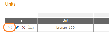

  1. Click on Managed Access | Property Management
  2. Click on the property that you want to change a unit to
  3. Click on Units Tab
  4. Create a Unit; pre-pend the word “bronze” in the unit number:
Image_ images_messages_6092b45fa31fd9684f29c596_074e0afc58007d012abd543057e1c8be_1-3d4e3fb3-8c8c-4e08-9f67-e12a8d084fe8-46734060.png

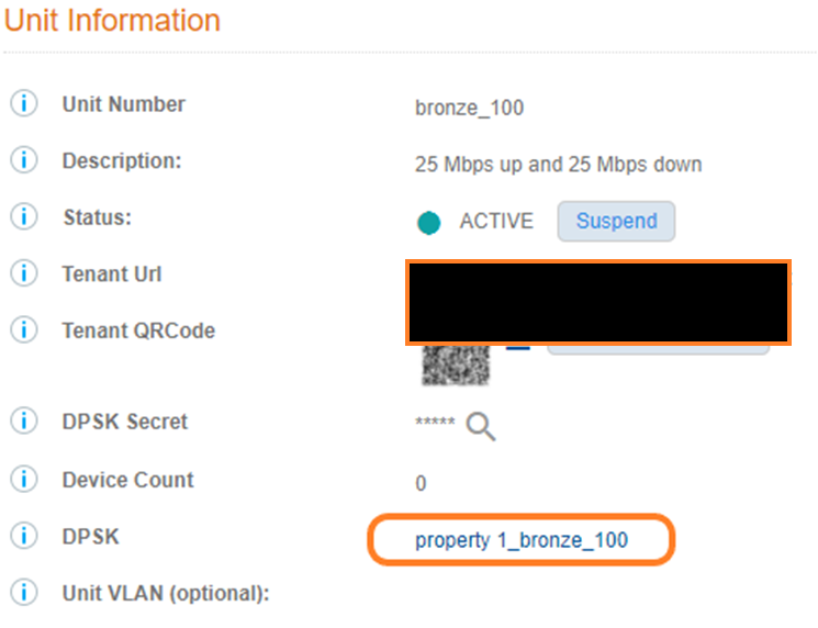

If you look at the bronze unit, you can see that the DPSK reference name is named as <property_name>_<unit number>.  We can use this value to build a RADIUS DPSK policy on:
Image_ images_messages_6092b45fa31fd9684f29c596_49af98fe6d6cea4d05195cb10cb897bb_3-b7bfafbb-6abf-4b8d-8edb-52bc80d300fb-48581102.png
Image_ images_messages_6092b45fa31fd9684f29c596_20ce40379a8e9ec3a1c76da93004835b_4-6e4ead65-e5f8-4589-b5db-d2f92c2a8c9f-49504623.png

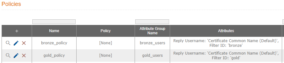

  2. Click the Policies Tab | Add Policy
Image_ images_messages_6092b45fa31fd9684f29c596_ace0dbe90de7afc7ef271fdc7036e342_9-a70c810d-bbc9-41d8-8e97-b1e9c02605e7-54122228.png
  1. Create a “bronze_policy” that returns the Bronze Attribute group that you just created. We are going to use the DPSK reference name for the Unit (remember, we pre-pended the word “bronze” to it):
    Image_ images_messages_6092b45fa31fd9684f29c596_3949f5b20e465c4a19d3c975c230b70e_10-462e4137-8d4b-400a-bcdf-f3c621cff25d-1448638938.png
  2. Make sure that you have a “.*” at the beginning and end, which means, match anything, then the word bronze, and match anything after that. This is REGEX, and I typically use a few different sites to test these things.
  3. Make sure that you select the correct RADIUS attribute group you just created for BRONZE
  4. Click on Save.

  1. Lets do a policy for “gold” users
Image_ images_messages_6092b45fa31fd9684f29c596_0cc2f34b2534e73350e5cf697de70230_12-56f8bcd2-63a2-437e-833b-0efc33635d8c-1450485980.png
  1. Click on Save
  2. You should have 2 policies now:
Image_ images_messages_6092b45fa31fd9684f29c596_010d233b98bb29af4d304214302a1465_13-4cd6c77d-60e6-4b43-9c83-e896c3ead861-1451409501.png

Image_ images_messages_6092b45fa31fd9684f29c596_397739bde3184d64f0139757b4160435_16-26787e1c-b31b-46b5-ab46-840e98c0fd19-1454180064.png

  4. Create another one for “gold” with 100 Mbps FW traffic profile
  1. Create a User Role and a FW profile like we did for bronze, but for 100 Mbps service
Image_ images_messages_6092b45fa31fd9684f29c596_57f35dee62bcdac3021e49214745b865_21-925c8b95-2529-45ac-99cf-fe62698c0f66-1478191610.png
  1. Click on OK
  2. Click on OK
  3. Click on OK
  4. You should have two user-role mappings
Image_ images_messages_6092b45fa31fd9684f29c596_4e60ff6844ce5dc704e78ce3cde8a534_22-78015f7d-2d26-4a7f-9c76-f47fb7d7e83c-1479115131.png
  1. Click on OK to close the Cloudpath Authentication Server.
