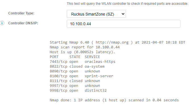

Great question! When you setup this in Cloudpath, the client/device will actually POST to the SmartZone port. So keep that in mind when working with MAC Registration workflow step.
When the client gets to that workflow step (mac-registration) Cloudpath will take the MAC address of the client (Cloudpath learns that on redirection) and stores it. What SmartZone needs to do is authenticate the client again. What Cloudpath will do is actually tell the client to do a POST to the SmartZone URL with it's credentials. SmartZone takes those credentials that the client provided it and will do a lookup in Cloudpath. Cloudpath will then send SmartZone an access accept message and the client is online.
You can see this in the Developer tools in a browser if you are interested! It will show up as "hotspotlogin". From there, you can see that the client does a POST to the SmartZone IP address with information that Cloudpath had provided it (those variables in the MAC-Reg workflow).
If you are using https 9998 I would recommend that you put a valid certificate on your SmartZone.
SZ should have that port available, and you can test that in a few different ways. I am making an assumption that you can connnect to SmartZone without it being behind a FW or NAT or something else to inhibit communication.
Use Cloudpath's WLAN controller port checker (works on premise or hosted):
1. In Cloudpath, can you click on Support | Diagnostics
2. In the Diagnostics window, click the WLAN controller tab
3. If not already selected, select SmartZone
4. Enter in the IP address of the SmartZone controller
5. Click on "run" on the top right
6. You will get output showing what ports are available on the SZ
Example:
