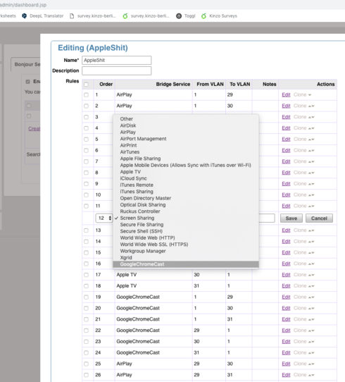

How can we define ports? I only see pre-defined names (no port info) in a dropdown list.
Are the posts for these pre-defined names available in the documentation anywhere?
