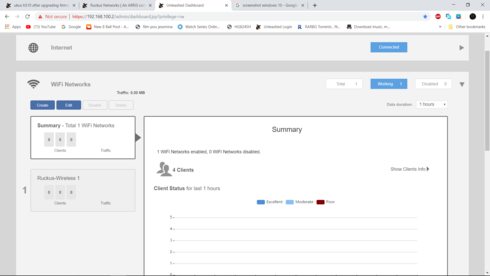

Image_ images_messages_5f91c44f135b77e247a18c39_ba9c2908631ed3c3d4a6981ad383057a_RackMultipart2019051638578l3ev-f0592878-f8f6-4a08-b7dc-a2ebadebfa42-2110409059.png1557995422
HERE YOU WE HAVE ONLY THE  SSID CREATED AFTER UPGRADE TO UNLEASHED
THE GENOVA SSID CREATED BEFORE  CONFIGURATION IS NOT VISIBLE

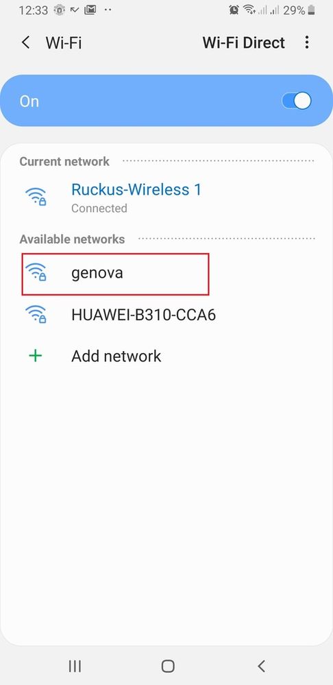

Image_ images_messages_5f91c44f135b77e247a18c39_e2007541b940c7776db261338c18171e_RackMultipart201905163919410kh-6b4b378b-ebaf-478d-ba90-a3b24ad6a5cf-147278788.jpg1557995723
In this picture you can see that The SSID GENOVA is still there.
password also still active and the same every one who knows the password can connect to it.
