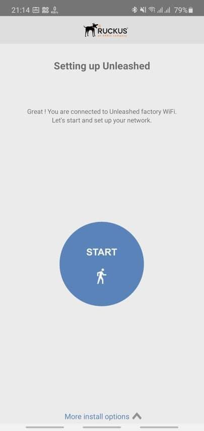

07-31-2020 09:33 AM
I tried connect unleashed r310 to my android app but no success. My unleashed version. 200.7 . my phone Samsung note10
