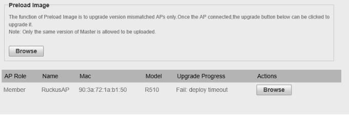

I have one R510 AP and I want converted to standalone mode, I have reset it and connected via 192.168.0.1 on internet explorer and tried to upgraded from local but for the moment I face with this message and doesn't let me to upgrade from local
and I have also tried to upgrade online but again I face with this message:
Do you have any ideas or solution?
