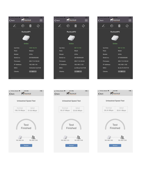

5- Third AP is connected to root AP directly or there are more than 1 mesh hops?
Image_ images_messages_5f91c452135b77e247a2305b_198084753ced4d9e4645eaeb88c9254a_RackMultipart20200507716661m0p-b28c5e17-7c34-4232-b44b-29bd00400135-1408096749.png1588862459
Hi Lynn,
If you could confirm which one is root AP in this diagram.
As per my understanding, AP1 is root, AP2 is mesh and connecting to AP1 and AP3 is connecting to AP2 (one addition hop).
If you have access to Unleashed GUI, go to mesh settings and try to manually select mesh uplink for AP3 and see if you can map it to AP1 directly (Root AP).
As explained before, with each additional mesh hop, throughput will decrease by 2.
