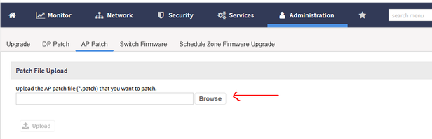

12-08-2023 02:33 PM
You must upload the 5.2.2 AP Patch in the AP patch section:
https://support.ruckuswireless.com/software/3659
Administration> Upgrade> AP Patch
