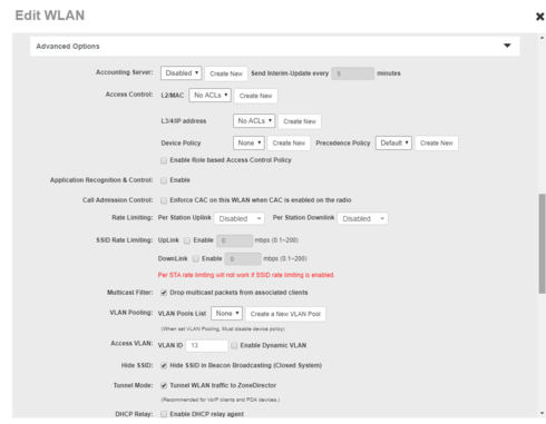

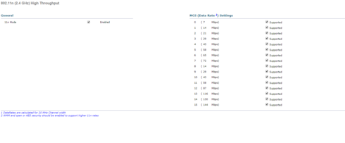

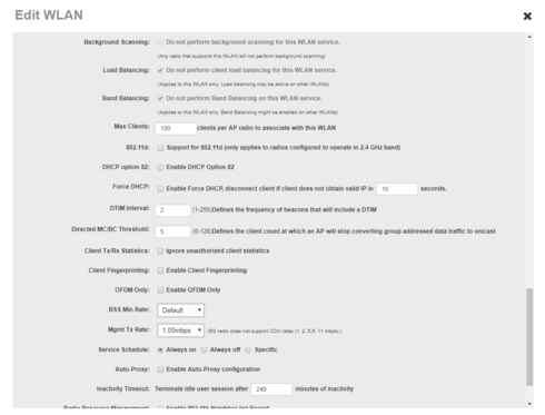

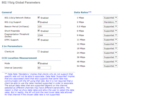

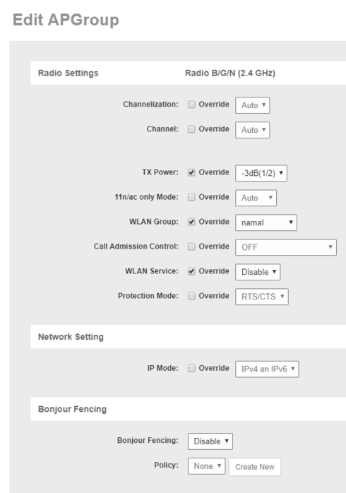

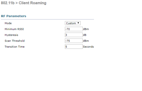

yossi_hershko
Hello
Sorry for the late reply
I attached few photos of the configuration both ruckus and cisco  ( Ruckus changed a lot during the tests, this is the current settings )
Note: the TX power is -3db 1/2 because we are at country code US at the moment which is 200mw. ( In Israel only 100mw is allowed ) so...
Thanks 🙂
Image_ images_messages_5f91c459135b77e247a3943d_982fed8894a016b8934bad89273be931_RackMultipart20190617128653dl9-d697e836-8cbb-45c6-b803-20a6780036b1-519132014.png1560754638
Image_ images_messages_5f91c459135b77e247a3943d_36338b0452d4b6cf6f81fbb4b517573a_RackMultipart2019061780780hgud-c012c8f2-e3cf-4974-9d37-f0fff69d6024-1741653552.png1560754661Image_ images_messages_5f91c459135b77e247a3943d_6f8ade315e5222768fe058818a94c5af_RackMultipart2019061760068cb8s-4fa07551-aa28-45e9-98c6-fff063e2a6c6-68511639.png1560754664Image_ images_messages_5f91c459135b77e247a3943d_b92d9a5fe1bf263d6da9276427240d3b_RackMultipart2019061716913b3rk-bb45a694-f513-46da-b82b-f0ea6e8065cb-1614738813.png1560754676Image_ images_messages_5f91c459135b77e247a3943d_223f696c03bbcc7ead6d697a1bca45eb_RackMultipart20190617928425xto-7f4b6516-5be3-4b90-97d0-b0c36cc42a32-39671967.png1560754682Image_ images_messages_5f91c459135b77e247a3943d_f6d92759f13422ef5ca5a705adabf44d_RackMultipart2019061783552rgot-04716461-41cc-4ea4-bd12-10fc90bd2bf4-655339581.png1560754685Image_ images_messages_5f91c459135b77e247a3943d_da38600a868c9f8f2b634ef06dd7e1e7_RackMultipart20190617354341ts7-2746b705-8933-4a60-a596-67b9a6c61be9-970633088.png1560754689
brian_powers
New Contributor III
Turbine,
That all looks as similar as it can be.  I do wonder though what the Default value means for BSS Min Rate.  As the help file doesn't explicitly state what data rate is used when Default is selected.
"BSS Min Rate: Use this option to configure the minimum transmission rate supported by the WLAN. If OFDM Only is enabled, the only valid options are 12 Mbps and 24 Mbps, with Mgmt Tx frames fixed at 6 Mbps. This option can also be used to prevent 11b clients from connecting, and to allow greater client density with higher data rates."
What options are under that setting (1, 2, 5.5, 12, 24)?  It may be worthwhile to set it to 1 or 2 (to match the data rates set in the Cisco solution.
Also, are you at the site and able grab a .pcap file of the environment during the time that the client devices are struggling to function properly?  That may shed some additional light on things.
