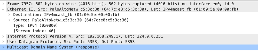

I've attached a packet capture from my network where my Palo Alto firewall is relaying an MDNS packet from my phone on the guest wifi - see how the source MAC address says it's a Palo Alto device, and not the iPhone that actually has the source IP of 192.168.249.17?

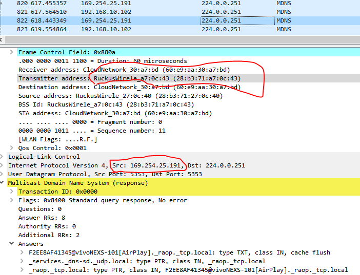

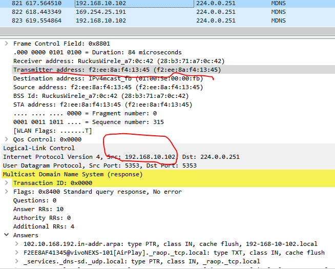

I'm sure the spurious packets are created and send by Ruckus, and the attached figures are evidence: I sniff the traffic on the wireless network, and find the device that is sending the MDNS packet with mac f2:ee:8a:f4:13:45 and IP 192.168.10.102 (figure 1). But in figure 2 I also find the spurious packet on the wireless side with MAC RuckusWirele_a7:0c:43 (28:b3:71: ) and IP 169.254.25.191, which means the spurious IP 169.254.XX.XX is not Something failing to obtain a DHCP address and falling back self-assigned IP, it is definitely assigned by Ruckus!

So, you think the Ruckus is responding to MDNS requests and it suddenly decides not to do it when you turn off the Bonjour gateway, rather than it being a rogue device on your network. Ok! I think you still haven’t grasped how a Bonjour gateway works if you think that the MAC address being the Ruckus is a smoking gun?
Have you tried expanding the MDNS answer fields to see what information the ‘Ruckus’ is sending?
Would I be correct in guessing that the wired side of the network doesn’t have DHCP configured? Have you sniffed the traffic on the wired side yet to see if you can find the 169.254.25.191 device?
Do you know where the Vivo Nex phone is on the network? Is it the 192.168.10.102 device?
From what I can see on your capture, you are seeing Apple Airplay MDNS traffic. Looking through the _raop._tcp.local RRs should reveal some more information.
