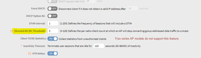

Could you let me know if the shared command helped? If yes, follow the steps mentioned below in vSZ.
1. Directed DHCP feature is reboot persistent and can be run through AP CLI script in vSZ. Navigate to Diagnostics Tab >> Scripts >> AP CLI Script, to run the AP CLI commands on all connected Access Points.
2. To disable Directed Multicast/Broadcast threshold, you can set the value to 0 in WLAN Config under Advanced Options.
Let me know if you have any further queries.

08-10-2023 12:38 AM
Hey, I tried the method you gave me.
It works, but I have a huge loss of ping from the mikrotik, and also when 2 devices are connected, it means that 1 goes first and the other goes second and therefore there is high latency on 1 of 2 computers.
