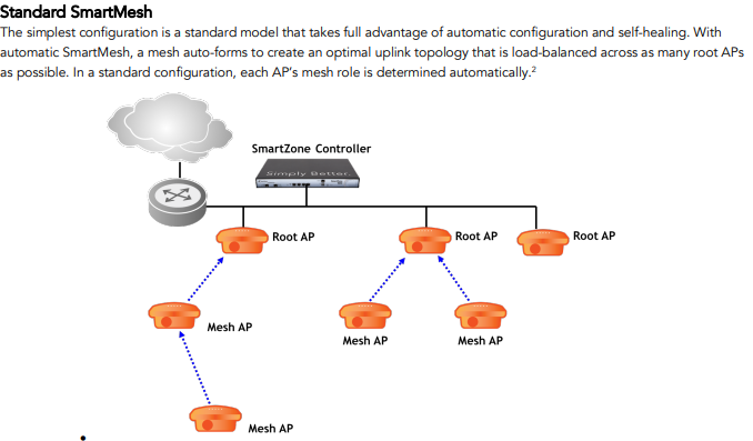

03-18-2021 03:23 AM
Hi Mohammad,
Mesh is a global configuration on the controller, so you only enable it once. Here is an example topology of a Mesh network:
I think you might find this best practice guide a useful resource. https://support.ruckuswireless.com/documents/2016-ruckus-wireless-mesh-best-practices-guide.
