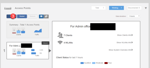

I have Ruckus R500 AP and where i can find Wireless radio settings to configure transmit power. I have this AP at home so i don't need hi power at home. Firmware: 200.5.10.0.235 (GA) Software for R500
This option is very easy to find and configure in Unifi AP-LR and trying to configure this in R500. Pic attached. thanks

In the Unleashed GUI, you can click on the access points tab, and then select either the summary icon on the left to make global changes to all access points, or select an individual AP to change settings on that particular one. Once you select it, click edit above the list. You can then adjust the tx power for the 2.4 and 5 GHz radios separately.

Hi Zvii,
Please find the Screenshots, below.
Abilash PR.
Abilash PR.
