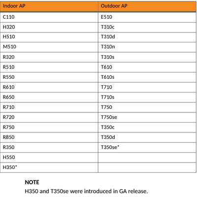

Yes you can configure Unleash in your network as single system using R650 and R610 AP's. Both these models are supported on the latest code too. Below is the latest 200.12 RN and supported AP in this release :
https://support.ruckuswireless.com/documents/4163-ruckus-unleashed-200-12-mr1-release-notes

Hi @coraise
