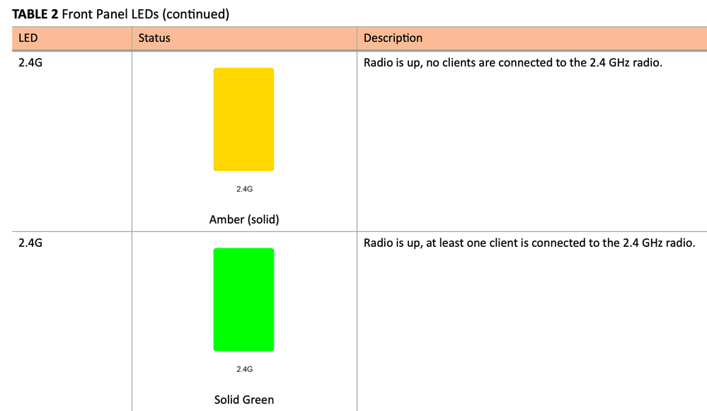

I lose connectivity on my client devices and when I go look at the R650 AP the 2.4 & 5 g LED lights are yellow. They then return to green and my Wi-Fi restores until the same thing happens again 60 -90 seconds later.

Hi Matt,
Orange displaying on the AP radio LED(s) is not the radios rebooting, it normally indicates there are no clients connected to the Wi-Fi radio.
Please note LED behaviour can change depending on what firmware type and version you are using.
If you are seeing clients frequently disconnect, this may be due to the AP changing channels, which if you are using ChannelFly, can be frequent in the first few hours of use. To test this, simply select fixed channels and see if the issue stops.
