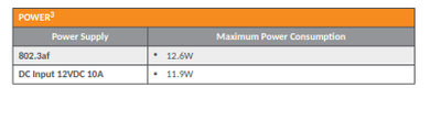

Please make sure the power settings meet the below table
