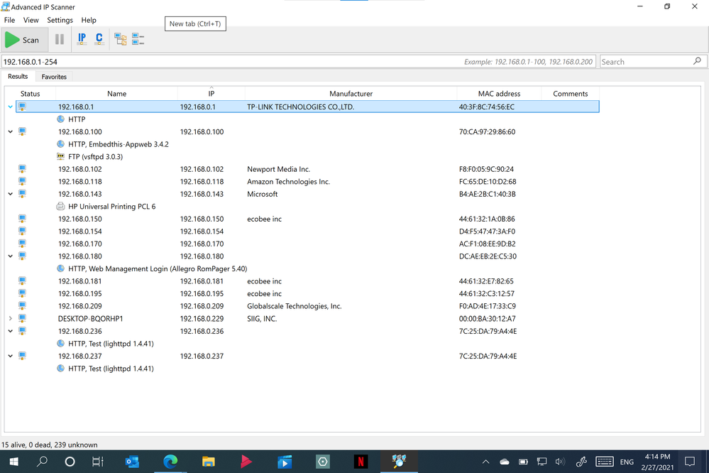

02-27-2021 04:18 PM
So I connected to that LAN socket and scanned with advanced IP scanner. Attached is the screenshot of the results. Though I'm not sure if the master AP was found or not.
