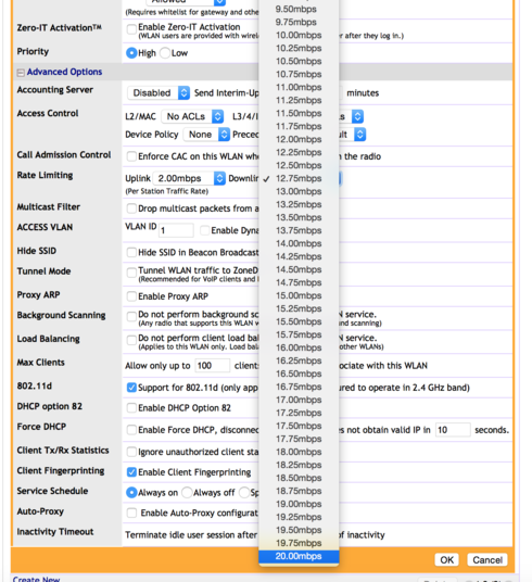

I am trying to limit my guest WLAN access to above 20mbps threshold, but the options max out at 20mbps. Is this normal?
Image_ images_messages_5f91c3e5135b77e2478d1136_e9eefa0a458ae84eadb9ef4167441216_Screenshot2014121918.53.31_inl-972555e0-299d-4904-b2a9-9d253ea030cc-1975141680.png1419040555

The rate limit is per station not per ssid, so you should limit stations lower.
