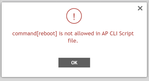

We have approximately 150 R710's deployed. The complex I work at has some power related issues. When this happens AP's come back up and can be communicated with via the webconsole but clients cannot get out to the internet. Typically I just reboot the AP that I see the client connected to and off we go.
What I would like to be able to do, instead of spending most of the day randomly rebooting AP's is just reset all of them at once when I see that we've had a power outage or interruption without having to click 150 blue arrows.
Is there a plan to have this ability implemented or another method to do this that anyone is aware of?

5.2.0.0.699. Create a new txt file, only put the word reboot in it, no more commands. Will that upload?

I'm using 5.1.0.0.496, so that could be the reason I cannot upload my script.

It must be, thought I could do it in that version, but I believe it works in 5.1.2
