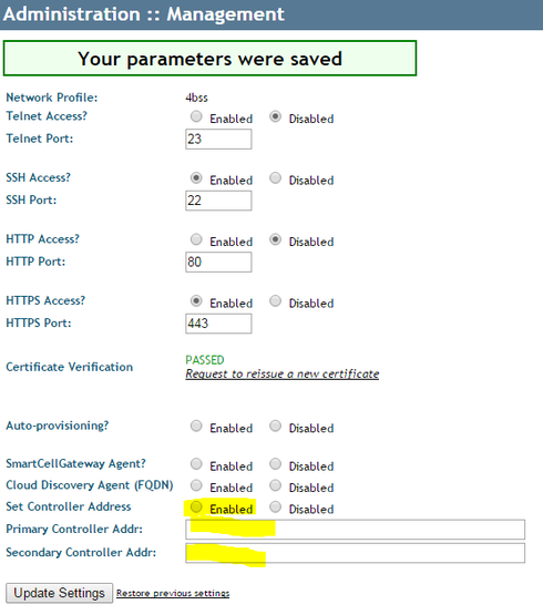

I tried to set controller address in 2 different APs (7343 and P300) via web interface and I was unable to. I get the confirmation message, saying that my parameters were saved, but nothing happens.
See below the images with the issue:
Image_ images_messages_5f91c3df135b77e2478c0056_c9155778d864f0a648cfa250b880b115_RackMultipart2016120298545qqha-02b0be5c-4694-47a0-9f06-f87dd68f5240-906366913.png1480689119
Is this normal behavior? Or can only be done by CLI?

On the P300 you cannot set controller, as there is no controller supported.
P300 is meant for bridge connection.
No vSZ/SZ/SCG or ZD support on it.
the other AP you should be able to set the controller ip.
Usually customers use CLI with set director or with the set scg ip command.
If you cannot the AP might be under control of a controller already, you can factory reset it and then try again.

I tried factory default and even after that don't work, I get the successful message, but the fields are empty.
If I use CLI I can set scg IP, as you said, but via web interface don't work. Do you know why? Is this a known issue?

I also noticed this issue when configuring the R500 with an IP for the controller but with a different set of choices (see below). I enabled the first 2 options and then the "Set Controller Address" was now active. Seems weird but worked for me in this environment as I don't have any DHCP/DNS running.
