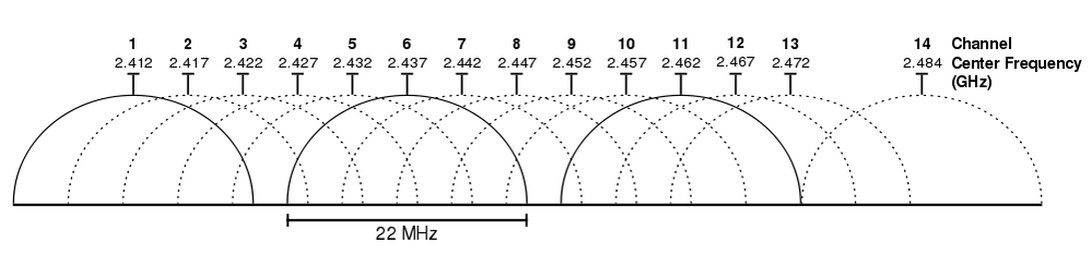

Thanks Andrea/Karl, I understood that is due to i enable all channels under my 2.5G channel rang, finally i changed my channel 1,6 and 11 as below to avoid channel overlapping . now my network is working fine no high latency or jitter.Image_ images_messages_5f91c42c135b77e24799de68_0396d4819443714acee4c77b4d500181_SWhAdDNLMG5zdGFuVGlWesGpx641fI-f7a64dfc-e227-4d25-bc35-fdb5a45f132a-679904312.png
