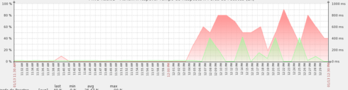

The problem is happening right now, the image below shows the results of our ping test (packet losses [red] vs response time [green]).
Image_ images_messages_5f91c416135b77e247956cce_9a04e1ce1e2ca892ca7a4ec7a453ff09_PacketLost_vs_ResponseTime_inl-e92cb8f3-0672-400a-92ee-04146c5cb118-397676444.PNG1389623516
The messages on the log show the same error, indicating interference in channel 100 and suggesting the change to 124.
Is it possible to let the device change the channel "on-the-fly", automatically? I thought that the SmartSelect channel supposed to do that.
