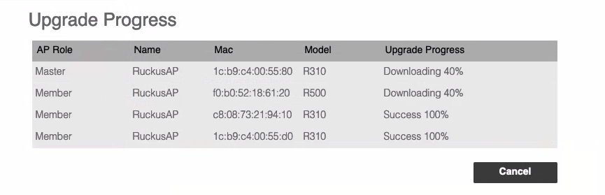

So, the first problem, that actaully may solve most of the headache: How do I upgrade the units to the latest firmware!? For the last 4 hours I have been able to update 2 of the R310's to version 200.7.10.202.141 (yes, it's taken that insanely long time, because more often than not the upgrade halted, the session closed (is there any way to stop that behavior!?), there was an error, the IP's didn't match, Reboots of the system one zillion times, etc etcโฆ).
As I write this I see this dialogue (btw, this is the first time I see 4 AP's in the list):
It has been on 40% for ten minutes now. Should I wat more? How long?

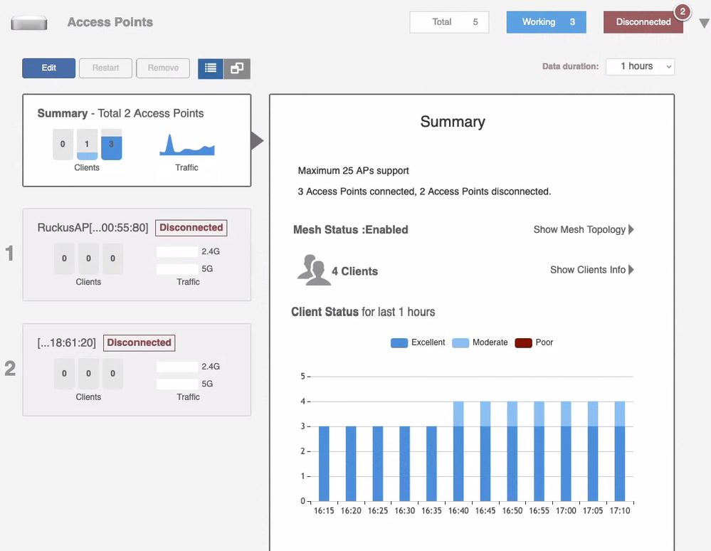

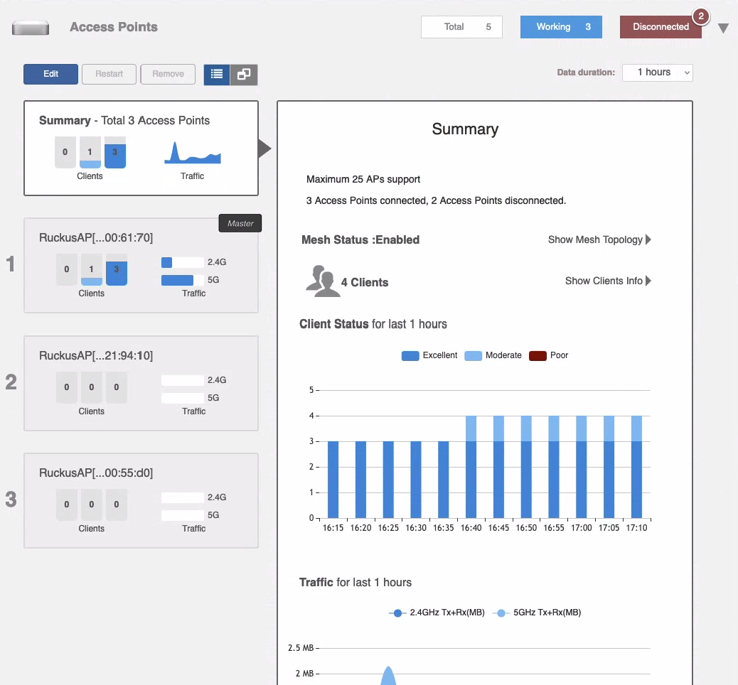

Before this, I did a restart of the system, and then it looked like this:
โ
โSome of these units switch IP's (or possibly MAC addresses) between restarts, which is extremely disturbing, and I don't have any explanation for that.

โ04-25-2023 09:41 AM
I did a LAN scan (the 10th today maybe), and now I can see 5 Ruckus units on the network, before there has constantly been 3.
Strange thing though is that the Same IP occurs two times, and the same MAC adddress occurs two timesโฆ (almost 3 times, the only difference is the exchange of 8 <-> d)!?
Is this normal with Ruckus units?

โ04-25-2023 10:03 AM
Hello @carlsson
Could you please confirm from which firmware version you are trying to upgrade the unleashed APs on 200.7.10.202.141?
Also confirm when you performed the upgrade which method you have choose online upgrade or Local upgrade ?
Also confirm if you have SSH access for those two APs which were unable to perform the upgrade.
If you have SSH into those APs you can upgrade them via CLI by using the FTP or TFTP. Please refer the below KB article.
โ04-25-2023 10:17 AM - edited โ04-25-2023 10:20 AM
OMFG!! I changed the IP number of the Master Ruckus R310, and now I see 5 AP's (whereas one of them have .12โฆ)!
