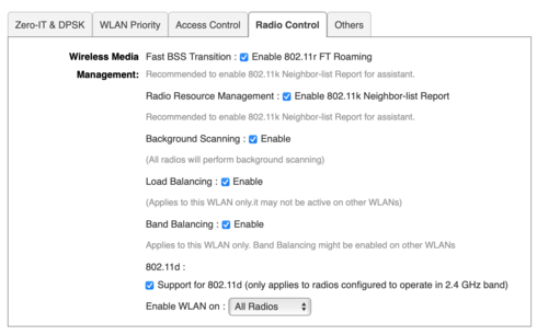

do I need to enable smart roam in all AP.s or just master?
Enable smart roam is applied to the WLAN level, not AP level, and thus once enabled on the master, it would be applied to all member APs broadcasting this SSID.
Do I have to enable other settings like disable multicast and dhcp or enabling smart roam is good enough?
This is my home setup on top of enabling Smart Roam with parameter 3 as well as enable ofdm-only.  Every network is different and also dependant on your end user devices support, you can do fine tuning from all the configuration changes you can make from the WebUI and the CLI.
Image_ images_messages_5f91c489135b77e247ad8e15_b44066a67a575797675513ce73dcaf99_RackMultipart202009141142482d7-b0ca5a46-e445-4445-9072-1df47705b20f-1850479502.png1600097704
