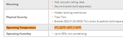

Mentioned Operating Temperature max 40c, but in our area Delhi, India Temperature rises up to 50c is that will effect the performance?

These are indoor APs, unless the users sit in such harsh environment without Airconditioned room, it shouldn't impact the AP performance. Though the max advertised temperature is 40C, we do consider a factor of safety and allowed to perform better with few degrees beyond that.
