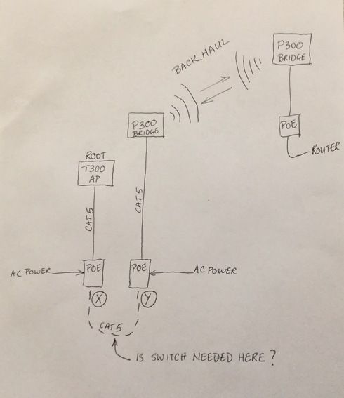

Thanks for the reply Michael. 7762 is not compatible with T300 unleashed and is being replaced. Unlike 7762, the T300 does not have an Ethernet/POE out port so I can't link it to the 7731 or P300 unit. The attached image is what I had in mind but I am not sure if I can make the link between X any Y in the diagram without a switch. I don't need to attach any other devices other than via wifi thru the AP.

09-15-2017 05:15 PM
Hi Ramesh
I can confirm the configuration in the sketch works fine. Only problem you might encounter is if the T300 can link back to the Master AP via a different route in the meshed network. In this case just manually configure your T300 to prevent loopback.
Regards
Russell
