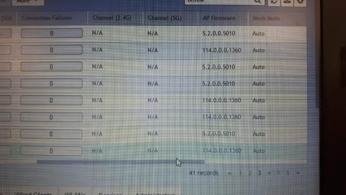

i have a project with 2x Smartzone100 and the following Access points
H320
R320-
R510
T310c
we commissioned the system as follows
controller version: 5.2.2.0.317
Controller plane version: 5.2.2.0.126
Data plane version: 5.2.2.0.21
AP firmware version: 5.2.2.0.301
NONE of the R320 Access points are working. all other are working great.
when we do a hard reset the R320 AP reboots and we can see the AP communicating
and it picks a IP address. then after a short while the connection times out
then we see that it reverts back to the default IP.
so we have communication for a short while and then it goes back to offline.

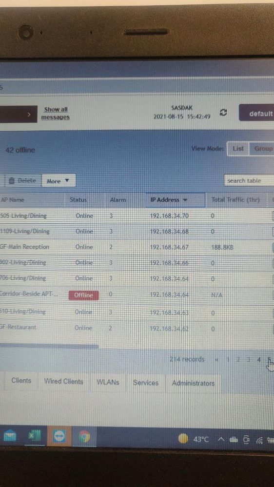

UPDATE: i have just returned from the project. we discovered that most of the R320 have a duplicate IP address
maybe about 80-90% of them have the same IP address has another AP.
R320s have two different firmware versions 5.2.0.0.5010 and 114.0.0.0.1360 on them
but the H320/R510/T310c have the latest 5.2.2.0.1026

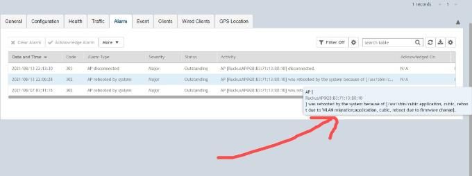

i can see the following msg in the log
Code 302 AP rebooted : AP [RuckusAP MAC address **time** ] was rebooted because of [/usr/sbin/cubic application, cubic , reboot due to WLAN migration; application , Cubic, reboot due to firmware change[
code 303 AP disconnected
